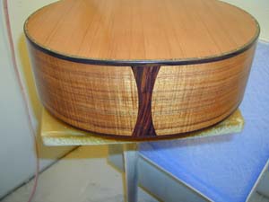

I like to use a curved end graft on my guitars, feeling that it's curves compliment the curves on the rest of the instrument.
I cut the first one by hand and it took the best part of a day to get it just right. I've come up with a jig that makes the whole process take less than 15 minutes. In fact a lot less time than it takes to write this tutorial.
It's a pretty simple jig. I had to add a second bit of timber to the piece of plywood in order to get enough depth, so that the flush cutting bit I use, has something to ride against. The dimensions of yours may vary.
You will also notice that I've marked the center line on the jig. It's just a matter of lining it up with the center of your back and top, then snug up the wing nuts on the threaded rods. Double check that everything is right, and then your ready to route the end graft cavity.
I set the depth of cut to just remove the thickness of the sides. You'll notice that I chalk in the direction that I need to route the top and back for the bindings. Anything that helps minimize mistakes in the rush of getting everything just so. The older I get the more I find I need little things as reminders.
I then use the end graft jig to mark out the piece that I'm going to inlay. I had to play with the design a bit to get this to work without a lot of painstaking fitting.
Although the piece is curved, it is actually also a wedge. There is a bit of leeway where the piece will fit. This makes it very easy to get a good tight fit with minimal work.
I have purfling running along the bottom of my bindings and around the end graft. Here I'm holding the purfing tight against the edge of the jig and running a sharp pencil along it. Cut close to the line and finish up by your prefered method. I use a drum sander in my drill press.
Trial fitting. It was a prefect fit first time up.
All glued in and ready to clamp.
Just light clam pressure. I've tapped the "wedge" in so it doesn't need any clamping in that direction.
Scraped flush and trimmed to the top and back, ready for routing of the bindings.
The finished end graft.
To complete the end graft/binding design I set my binding cutter depth of cut to JUST the depth of the binding (not including purfling) and do a pass over the end of the graft  plus a little on each side. This is important to do fist, as it it easy to get carried away if cutting the full depth and route the end graft off too deep...don't ask how I know.
Then I reset the depth of cut to include the dept of the purflings, and cut the the binding ledges in the  rest of the body, being very careful as I get near the end graft.
I bring the cutter JUST up to the purfling on the side of the end graft.
The miter is then cut with a very sharp chisel, using the polished back of the chisel as a mirror and watching the reflection on the back to tell me when the angle is right. Then make the cut.
For this to work the chisel needs to be really sharp or you'll just mash the purfling.
Hope this is helpful.
Allen R. McFarlen

That's really great, Allen.  Is the curve, an arc of a circle?  I know the curve would have to be consistent so it would act as a wedge too.
PostPosted: Mon Sep 10, 2007 7:37 am
Posts: 471
First name: Allen
Last Name: McFarlen
City: Mt. Sheridan
State: Qld.
Zip/Postal Code: 4868
It's an arc. I used a flexible steel ruler and bent it to get the arc that I thought would work. It took a few tries to get everything to work out, but this design has given my a fair bit of "wiggle factor".

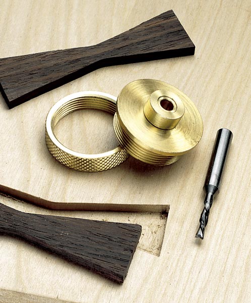

Why not use the jig to also cut the end wedge peice as well? Just seems like it would be much more accurate, not any more work to set up, and should eliminate sanding errors. You'd need to stop at woodcraft and pick up this....
PostPosted: Mon Sep 10, 2007 1:28 pm
Posts: 1584
Location: PA, United States
Allen,
I love the curved wedges too! That's why I looked for a good way to make em too. I tried to post the link but here goes again, for the Woocraft inlay kit
PostPosted: Mon Sep 10, 2007 1:48 pm
Posts: 565
Great tutorial Allen.
If you wanted to use that woodcraft inlay kit for cutting the wedge you would have to somehow take into consideration the depth of the purfling lines flanking the wedge. Those lines might vary from one guitar to the next depending on the decoration scheme. How could you make the inlay jig adjustable to allow for that variable?

[QUOTE=Terry Stowell]Why not use the jig to also cut the end wedge peice as well? Just seems like it would be much more accurate, not any more work to set up, and should eliminate sanding errors. You'd need to stop at woodcraft and pick up this....
I had thought of how this might be done, but don't have the kit that you have. In fact ,although Cairns is a small city, we are basically at the ends of the earth when it comes to getting anything a little out of the ordinary. You should have see the blank stares I got when I asked around town if I could get some 24" sanding disks for my radius dish. Most everything I have to get mail ordered and shipping gets to be a bit much.
Your right though, it would make the job more accurate, but I would have to be using the same binding on each guitar, or have to use a different collar, or shim it with tape etc. Back to trial and error and more fitting.
But as I said, the whole process has only taken 15 minutes from start to finish once the jig was made. I've used it on 2 guitars. The one I just posted and the current one I'm building.
